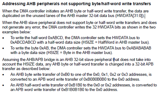

I solved the problem, I found the following information in the reference manual 12.4.6:
0693W00000Ly3d0QAB.pngAHB peripherals not supporting byte/half-word write transfers, so I change the data width to word, and it works fine.

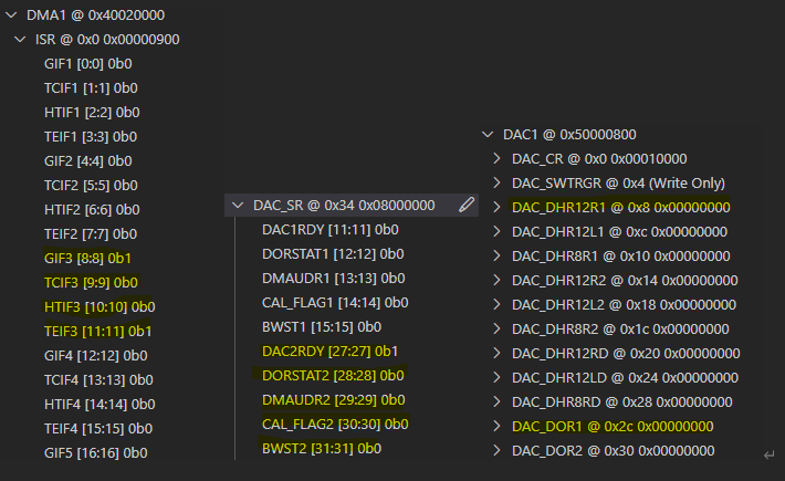

Is Data in a DMA-accessible location? Print out the DMA stream register information.

Thank you for your reply, and here is my DMA setup:
0693W00000Ly3S7QAJ.png​It should be the DMA accessible location
