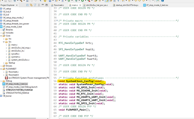

The image below shows how Cube MX allows us to control the visibility of some functions.
Uncheking a prototype moves it from main.c (private) to main.h (public). When unchecking for SystemClock_Config, its prototype is still generated on main.c, only the static keyword is removed.
It is a bug or for some reason is intented do not calll SystemClock_Config outside main()?

No,
Uncheking (Visibility Static) remove the static keyword, but prototype is still on main.c.
Checking (Visibility Static) puts extern keyword back, as expected prototype is on main.c
All the orthers functions in the visibility list work as expected, unchekeing removes prototypes from main.c and adds it to main..h

It's not a problem fo rme, easy to code a custom solution, but CubeMx is not consistent. Please se my response to Andrew.
