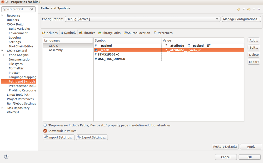

For success build without errors imported project generated in CubeMX, need fix generated symbols
In Project->Properties->C/C++ Builds->Settings->MCU GCC Compiler->Symbols
__weak=__attribute__((weak))
__packed=__attribute__((__packed__))need set values __attribute__((XXXXX)) in double quotes - '__attribute__((XXXXX))'
Sample:
__weak='__attribute__((weak))'
__packed='__attribute__((__packed__))'Else you can see follow errors after import

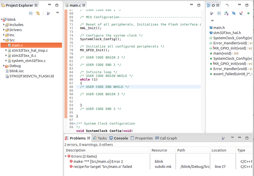

23:19:10 **** Incremental Build of configuration Debug for project blink ****
make all Building file: ../Src/main.c /bin/sh: -c: line 0: syntax error near unexpected token `(' /bin/sh: -c: line 0: `arm-none-eabi-gcc -mcpu=cortex-m4 -mthumb -mfloat-abi=hard -mfpu=fpv4-sp-d16 -Dweak=attributeweak? -Dpacked=attributepacked? -DUSE_HAL_DRIVER -DSTM32F303xC -I'/Users/asergeev/stm/workspace/blink/Inc' -I'/Users/asergeev/stm/workspace/blink/Drivers/STM32F3xx_HAL_Driver/Inc' -I'/Users/asergeev/stm/workspace/blink/Drivers/STM32F3xx_HAL_Driver/Inc/Legacy' -I'/Users/asergeev/stm/workspace/blink/Drivers/CMSIS/Device/ST/STM32F3xx/Include' -I'/Users/asergeev/stm/workspace/blink/Drivers/CMSIS/Include' -Os -g3 -Wall -fmessage-length=0 -ffunction-sections -c -fmessage-length=0 -MMD -MP -MF'Src/main.d' -MT'Src/main.o' -o 'Src/main.o' '../Src/main.c'' make: *** Src/main.o Error 2 Invoking: MCU GCC Compiler /Users/asergeev/stm/workspace/blink/Debug arm-none-eabi-gcc -mcpu=cortex-m4 -mthumb -mfloat-abi=hard -mfpu=fpv4-sp-d16 -Dweak=attributeweak? -Dpacked=attributepacked? -DUSE_HAL_DRIVER -DSTM32F303xC -I'/Users/asergeev/stm/workspace/blink/Inc' -I'/Users/asergeev/stm/workspace/blink/Drivers/STM32F3xx_HAL_Driver/Inc' -I'/Users/asergeev/stm/workspace/blink/Drivers/STM32F3xx_HAL_Driver/Inc/Legacy' -I'/Users/asergeev/stm/workspace/blink/Drivers/CMSIS/Device/ST/STM32F3xx/Include' -I'/Users/asergeev/stm/workspace/blink/Drivers/CMSIS/Include' -Os -g3 -Wall -fmessage-length=0 -ffunction-sections -c -fmessage-length=0 -MMD -MP -MF'Src/main.d' -MT'Src/main.o' -o 'Src/main.o' '../Src/main.c'#cube-mx-ac6-system-workbench-iap #stm32cubemxSolved! Go to Solution.

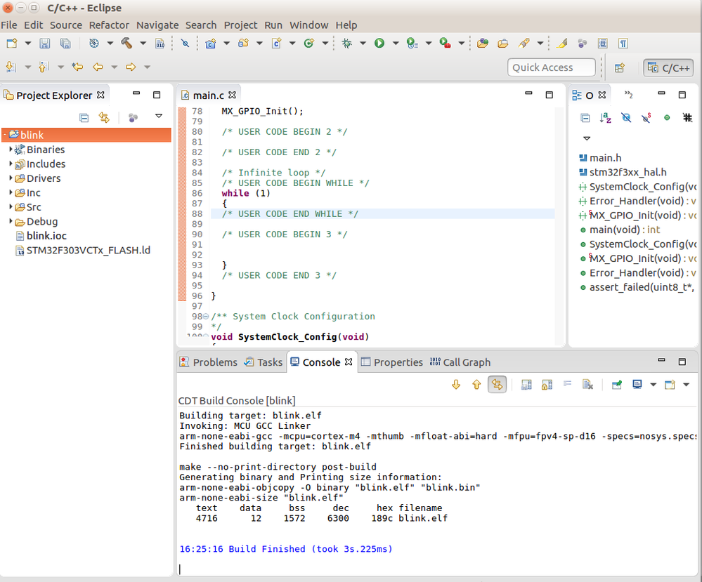

Build successfull...
