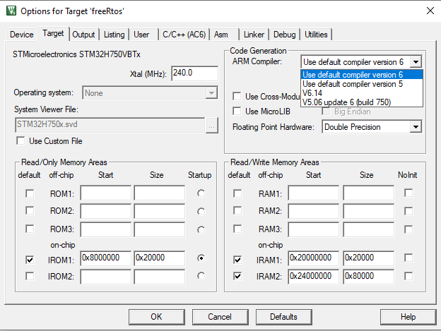

I can generate projects for keil with STMCube but when I choose FreeRTOS and keil, when I choose the compiler version to be V6, the build would fail. is there any work around this?

Hello @ali_dehbidi ,
After check, Compiler V6 is not supported (it's only supported with L5).

When will STM32CubeMX start supporting generation of MDF-ARM/Keil-compilable code which can be compiled using Compiler version 6?
As per my previous communication the only requirement is to REPLACE the FreeRTOS RVDS folder with the GCC folder.
Please help release this feature request ASAP.
