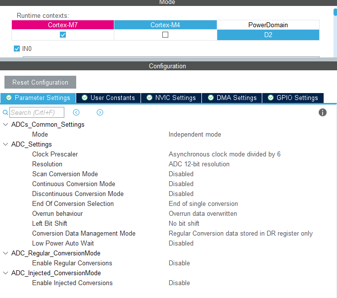

I am currently working with the stm32h747, trying to sample current and voltage using the internal ADC with its analog pins. My samples are wrong, the values sampled are coming out with a wierd offset (for example: 0 voltages is samples as ~1.87v). i can see that aplying votage on the pins or shorting them to GND gives some effect but the values are still wrong.
the init code is standard and generated by cubeMX, My cube defenitions look like this:

The issue was resolved by changing configuration in the cube and now we are able to read the data properly.
The only thing that is still alarms me that the old configuration which was basic worked on the F7 and did not work on the H7.
