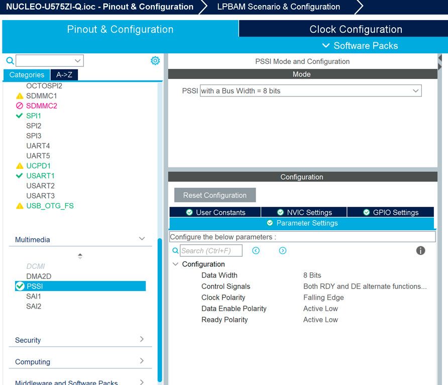

No PSSI DMA settings. Thought that the MCU does not support DMA, but the manual says that it does.
Current STM32Cube MCU Package v1.2.0
2023-05-22 7:55 AM
Hello @MPhil.4 and welcome to the Community :),
I confirm the issue: the tab of DMA settings does not exist in the configuration tab.
I reported internally.
Internal ticket number: 131975 (This is an internal tracking number and is not accessible or usable by customers).
Thank you for reporting this issue.
