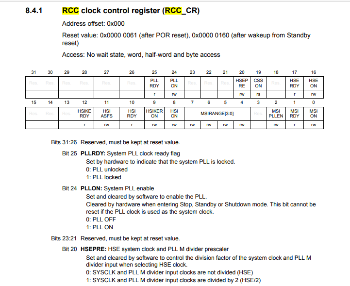

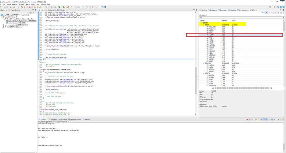

After generating the code (without changing the location of the generated call of function " __HAL_RCC_HSE_DIV2_ENABLE();" ) and debug it
and based on the RM0473 (8.4.1 RCC clock control register (RCC_CR )
The bit HSEPRE=1 as shown in the screenshot that means that the clock divider on the HSE is taken into account when calculation the peripheral clock dividers/periods.
I will be waiting for your feedback .
Thx
Ghofrane

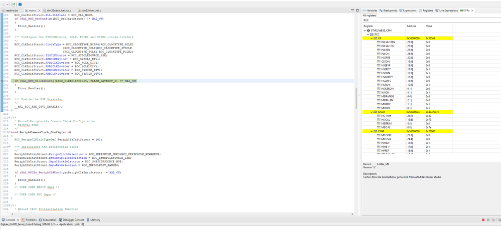

Thanks for the fast response. There was a national holiday in the Netherlands so I could not respond immediately. but I should have given a more in depth explanation.
The HAL_RCC_ClockConfig uses the HSE clock divider to calculate the configuration of the SysTick timer. But as shown in the image below the HAL_RCC_ClockConfig function is called before the clock divider is set.
this will cause the SysTick timer to be set without the correct clock config.
another way to see this is:
So if __HAL_RCC_HSE_DIV2_ENABLE is called after HAL_RCC_ClockConfig the div 2 config will not be used in HAL_RCC_ClockConfig. The HAL_RCC_ClockConfig uses HAL_RCC_GetHCLKFreq to set the SystemCoreClock so if the clock divider is changed after the fact, the SystemCoreClock is not set correctly. and that is the same for the SysTick timer set in HAL_RCC_ClockConfig.
With kind regards,
Nick Assink
