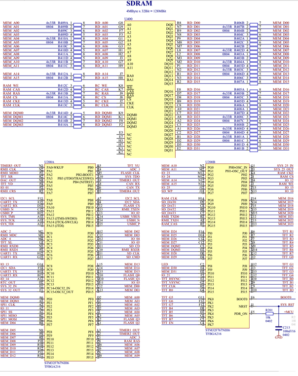

Here is the connection between the MCU and SDRAM:

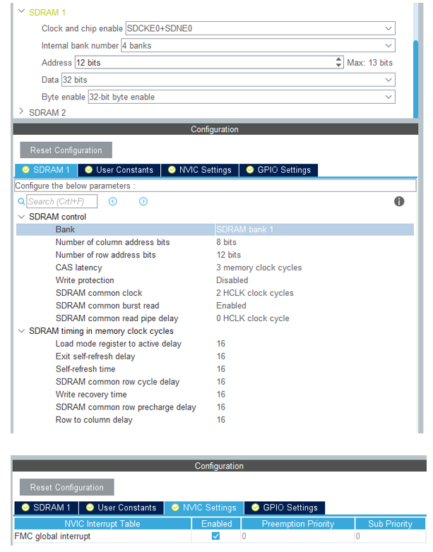

My settings in CubeIDE:

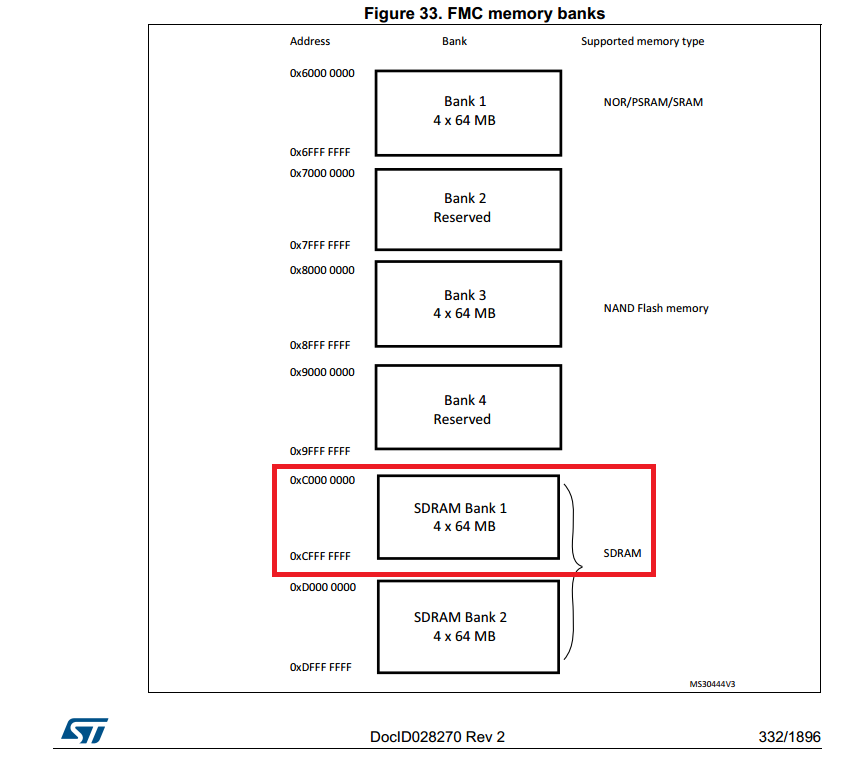

When I read the datasheet of the STM32F7x then it says, that the starting address for the external SDRAM connection shall be the 0xC000 0000:
So I have used this as the starting address for my SDRAM. By this I shall have a maximum address space of 0xC000 0000 - 0xCFFF FFFF.

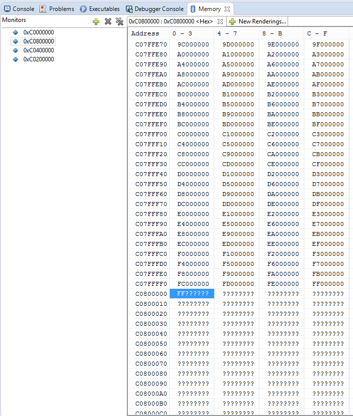

When I use the memory viewer during debugging, then I can see, that addresses only up to 0x0080 0000 are mapped:
This means, that only 2 banks are mapped. I have set the CubeMX for 4 internal banks, so I'm wondering what I did wrong?
Why the mapping is going only up to the 0xC080 0000?

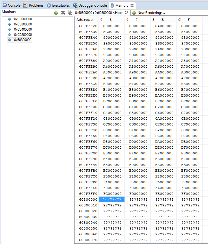

The 2. solution is to remap the memory to another region of the STM32F7: 0x6000 0000. This also dosen't help. Here the screen shot with my code redirected to 0x6000 0000:
The problem is the same -> nothing above 0x6080 0000...
