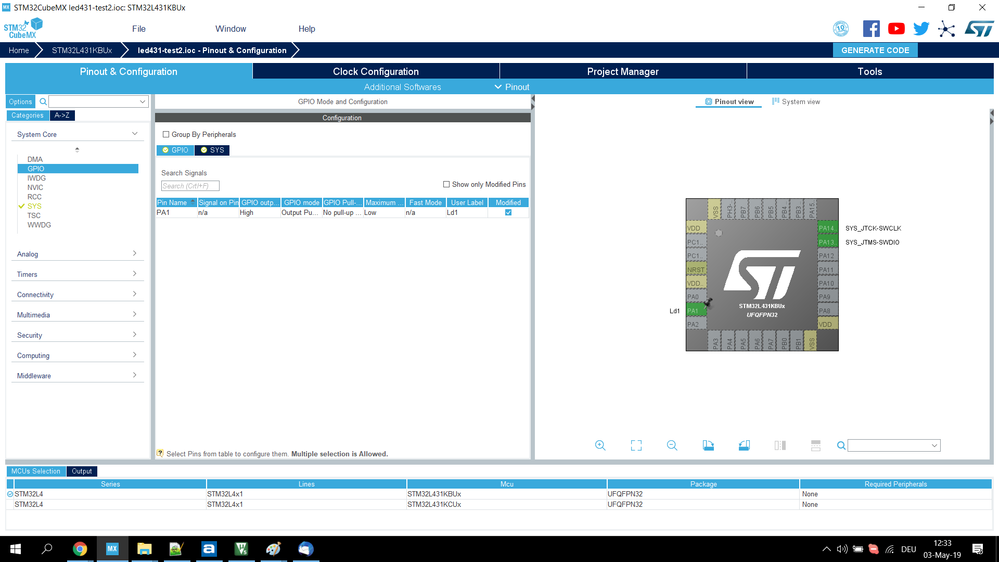

So I got this STM32L431KBU6 chip on breakout and I can't get it to start. Here is the GPIO config,

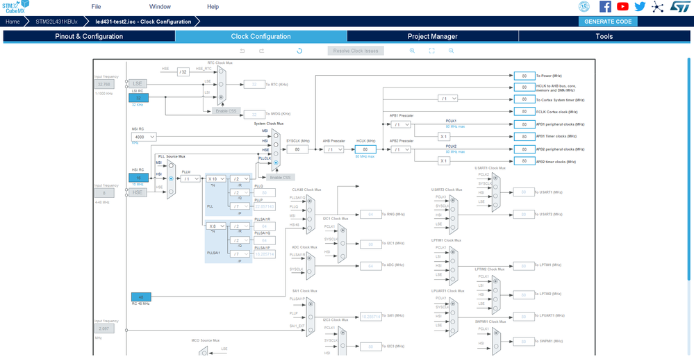

and the clock config. That is one from many I tried, I only tried with with internal clocks, MSI in different configs and HSI with different combinations of multipliers and dividers

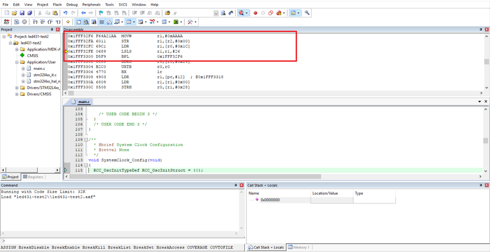

When I run a debug in Keil, I just can't get past some cycle. I think it's already some error handler, but I don't get it shown in C code.
