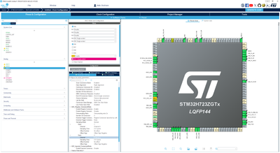

I am using the STM32H723ZG board with MATLAB STM embedded coder support packages and I configured the STM32H7 MCU peripherals for ADC1,ADC2 and ADC3,PWM and GPIO, i can see the signals on the GPIO output pins and PWM when I don't use the multiple configuration's in the ADC but When I configure the Multiple channel ADC configuration, I could not see any signal on the GPIO and PWM pins, Can i know is there any issue with DMA configuration with Multiple channel ADC?
Attached the multiple channel configurations for ADC in the picture.

I used CubeMX 6.12.0 in order to reproduce the issue mentioned above and this is what I got --> all the signals are there even after using the multiple configuration's in the ADC
So I would appreciated if you share your IOC with me in order to push further the investigation.
I will be waiting for your feedback.
