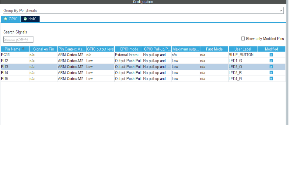

2021-02-15 11:09 AM
Hi there,
I had the same problem. The reason for me was pretty simple.
Since I am working on a dual core, I had to assign a "Pin Context" (M7 or M4).
After having assigned that, it worked as expected.
Here is a screenshot of the configuration
Hope it helps you too!
Johannes
2024-12-11 1:31 AM
This worked for me.
Thanks!
