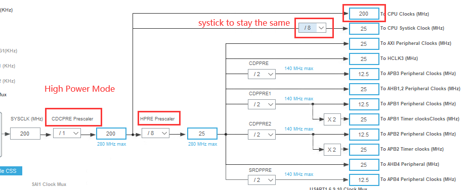

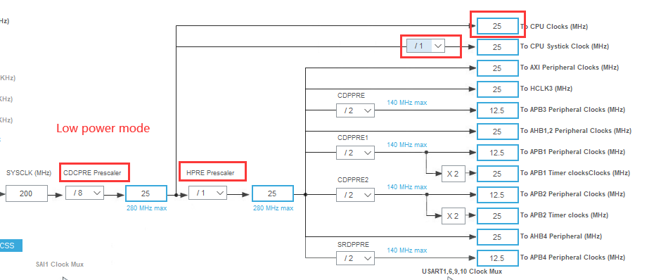

I am trying to implement some low power in my MCU but not looking for extreme standby mode. I first try to stop CPU but it doesnt save too much power because the AXI are still running at high frequency. Then I try this, a dynamic CPU clock (possibly with AXI memory clock).
From the clock tree, I can see there are 2 registers to control the clock to CPU and most of the peripherals. My goal is to change the CPU clock without affecting the peripherals clock.
I am using an RTOS so I can easily know when to enter idle thread (task) (reduced CPU clock) or user thread (high CPU clock). I implement the below codes to switch between high and low clocks. These code are called bay RTOS's scheduler, when it switch to idle, call low_performance, when it switch to user threads, call the other.
static inline void cpu_high_performance()
LL_RCC_SetSysPrescaler(LL_RCC_SYSCLK_DIV_1);
LL_RCC_SetAHBPrescaler(LL_RCC_AHB_DIV_8);
HAL_SYSTICK_CLKSourceConfig(SYSTICK_CLKSOURCE_HCLK_DIV8);
static inline void cpu_low_power()
LL_RCC_SetAHBPrescaler(LL_RCC_AHB_DIV_1);
LL_RCC_SetSysPrescaler(LL_RCC_SYSCLK_DIV_8);
HAL_SYSTICK_CLKSourceConfig(SYSTICK_CLKSOURCE_HCLK);
After a few trials, the MCU is sucessfuly running with 200M/25M now.

I did meet some problems during trials, such as the OPSI clock being too high (200M) which the CPU being only 25M, the whole system stop working (cannot even enter hard fault or download firmware). Another problem is the clock in interrupt will sometimes be the low frequency 25M, but it seems ok. If it doesn't, I can still implement the clock change in the interrupt.
The power saving result is quite significant, I save 50% of power consumption with the dynamic clock compared to 200M while my system load is only 20%.
My problems are, whether this method is correct? What are the other possible issues?
Thanks.

You can change the system clock dynamically as many times as you want and as often as you want. It can take time for the PLL to be ready, but generally this is negligible.
However, if you are clocking the peripherals off of this, there is no way to get around the issue of the clock speed changing. For SPI/I2C, this is likely not an issue if you use a slow enough speed, however UART is going to have problems.
You can disable UART before the change and re-initialize it after, but of course you will miss characters if they are being sent.
On this chip, many peripherals have multiple clock sources. You could select a clock source which does not change when you do the CPU clock adjustment to eliminate this issue. For example, use PLL3Q to drive USART1 independently from PLL1P (which drives PCLK1) which is used to drive the CPU.
