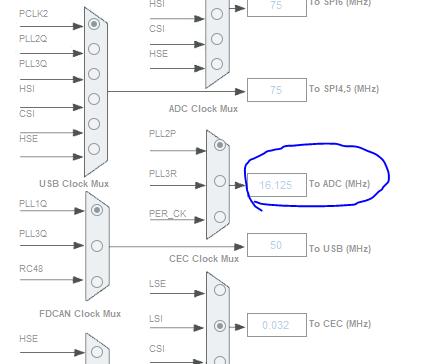

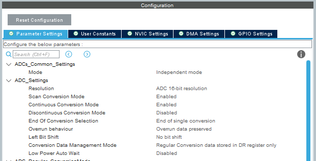

The said version seem to have missing ADC "Clock Prescaler" in the configuration menu and ADC clock generation is locked disabled in the "Clock Configuration" menu even when ADC is set enabled.

Image 1: No "Clock Prescaler" menu in the ADC configuration menu
Image2: ADC clock configuration is locked disabled even when ADC1 is set enabled.

2022-06-29 8:08 AM
Hello @GOh.4 ,
This issue is fixed in STM32CubeMX latest release.
V6.6.0 is now available under this Link.
Thanks for your contribution.
