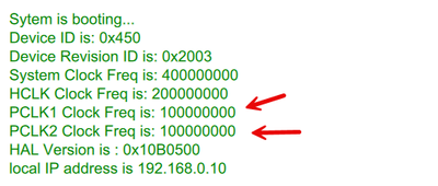

By the way, RCC clock auto configuration is also wrong.
but result showing:
which will mess up UART baud rate ( I have to chage UART clock source to HSI to get correct UART output, the old is PCLK1), same issue as the post you linked.

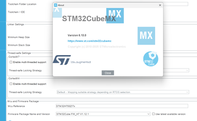

I was aware that 1.12.1 has a bug fix about RCC. But the wrong result is with the latest firmware 1.12.1 and 6.13.0 MX

OK I get it. It looks like STM32CubeMX generated code doesn't consider the updated template for system_stm32h7xx_dualcore_boot_cm4_cm7.c. I reported this issue internally (199524).
The correct one should be based on the template available under STM32Cube_FW_H7_V1.12.1\Drivers\CMSIS\Device\ST\STM32H7xx\Source\Templates.
In the file <generated_prj>/Common/Src/system_stm32h7xx_dualcore_boot_cm4_cm7.c, try to replace:
const uint8_t D1CorePrescTable[16] = {0, 0, 0, 0, 0, 0, 0, 0, 1, 2, 3, 4, 6, 7, 8, 9};
by
const uint8_t D1CorePrescTable[16] = {0, 0, 0, 0, 1, 2, 3, 4, 1, 2, 3, 4, 6, 7, 8, 9};
That should fix the issue.
