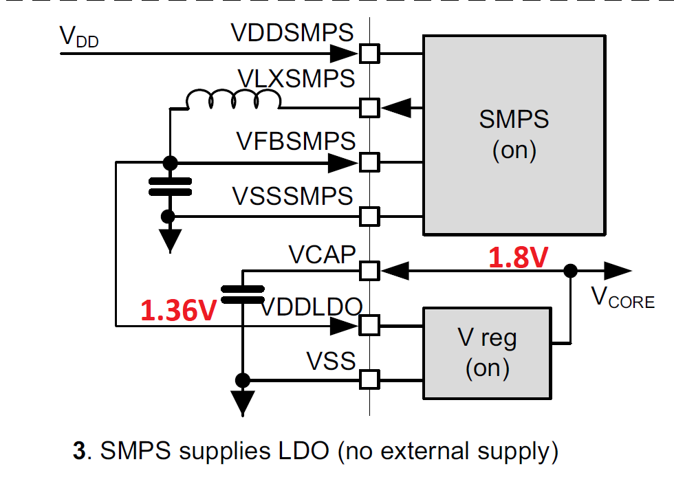

With the hardware layout n°3 ("SMPS supplies LDO" in the above picture), the SMPS seems to be active:
  • VDD = 3.3V
  • VDDLDO = 1.8V
  • VCAP = 1.36V
The internal sensor returns a temperature between 55°C and 60°C.
When disabling the SMPS (firmware configuration = LDO_SUPPLY), VDDLDO and VCORE are set to 0V and the MCU remains stuck (thus I can't get the measurement)
Edit: voltage measurements were swapped
So this is the situation you have:
0693W00000bhZElQAM.pngwhich is very curious.
How can the output of a linear regulator "V reg" be higher than the input?
EDIT: did you maybe reverse the order of the voltage nets?
I have now measured on my board, VDDLDO is 1.8V and VCAP is 1.36V.

@O'li​ With the above measurements, did you see the SMPS switching?
If it is really on, you can check with a scope at pin VLXSMPS or at the side of the inductor without the cap (so not the 1.36V side).

@Community member​ I think he has reversed the values of voltages.
I have now measured it on my board and VDDLDO is 1.8V and VCAP is 1.36V.
And also I have confirmed that the SMPS is working, the switching node before the inductor is outputing 2.3 MHz square wave and is regulating since the duty cycle is changing.
I have the same layout n°3 ("SMPS supplies LDO" in the above picture).
Yes indeed, I'll edit my post to prevent further confusion
Same as @Domagoj Tomić​, I get a 2.3MHz square wave
