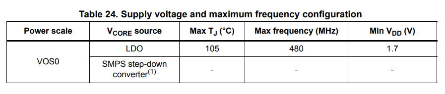

Foued_KH
Hello @Domagoj Tomić​ ,
As mentioned in the Table 24. Supply voltage and maximum frequency configuration in the datasheet 12923
0693W00000aJZ6zQAG.pngVOS0 (power scale 0) is not available when the SMPS step-down converter directly supplies VCORE.
Foued

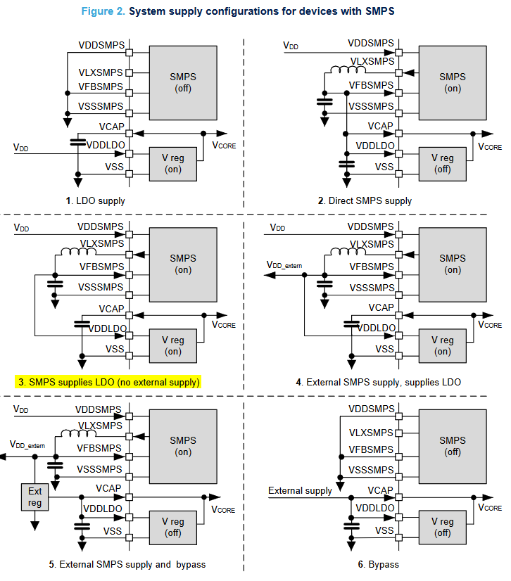

Are you talking about PWR_DIRECT_SMPS_SUPPLY option?
Does SMPS supply VCORE directly on PWR_SMPS_1V8_SUPPLIES_LDO option too?
"Are you talking about PWR_DIRECT_SMPS_SUPPLY option?"
I think he is, but I'm talking about PWR_SMPS_1V8_SUPPLIES_LDO option.
My understanding is that with the "PWR_SMPS_1V8_SUPPLIES_LDO" configuration, the VCORE is sourced from the LDO, that's why I'm confused why that option is now not available and it was in the older CubeMX.
