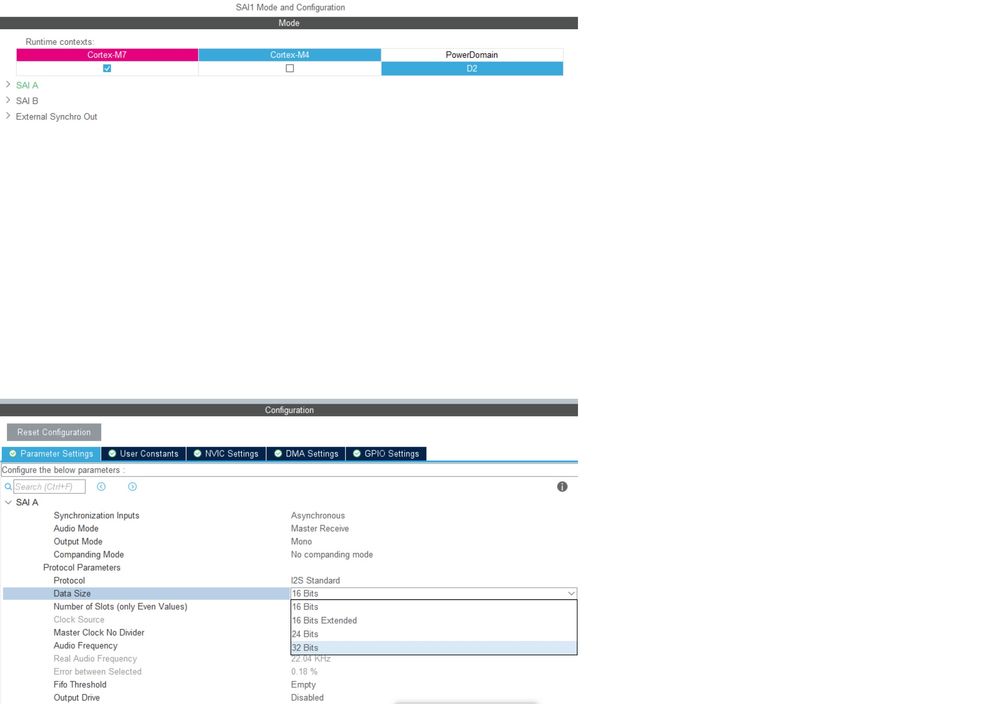

i'm using stm32h745 mcu.
i want to using SAI interface to use MEMS MIC, ADAU7002 .
this sensor transmit 20bit PCM , 22050 hz data.
i used CUBEMX and SAI & DMA setting is here.

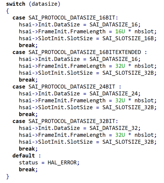

i can't select SAI interface data size 20bit, so i fixed HAL Driver to set datasize 20bit, but i don't receive 20bit data.
i can receive only 16bit data.

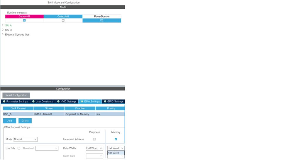

i think that occured problem by dma.
can i fixed dma setting change half word to 4byte words??

As you have already noted, the only supported Protocol data sizes in both CubeMX and the HAL driver are mentioned below.
What is the behavior if you set Data Size to the value "16 Bits Extended" in STM32CubeMX?
