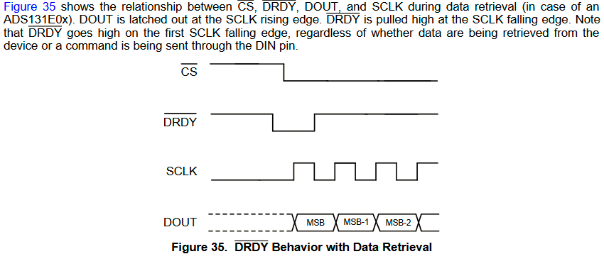

As per the sensor datasheet: DOUT is latched out at the SCLK rising edge. DRDY is pulled high at the SCLK falling edge. Note that DRDY goes high on the first SCLK falling edge, regardless of whether data are being retrieved from the device or command is being sent through the DIN pin.
DRDY is the interrupt that active low. here I have attached the datasheet snap.

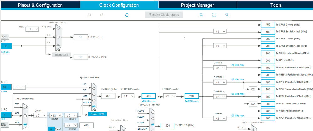

0693W00000StfFYQAZ.pngI have configured coreM7 CPU clock 400Mhz. And code optimization level is 0.
