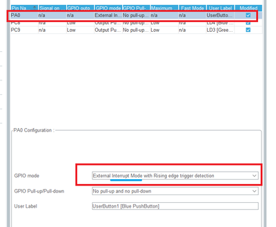

@johannv99 wrote:
also when set a breakpoint in. HAL_GPIO_EXTI_Callback() function.
This is because you set EXTI in event mode and not in interrupt mode and the NVIC configuration is missing. Fixed you ioc file in attachement.

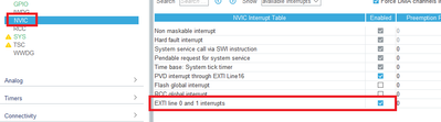

You need to set interrupt mode:
And in NVIC menu to enable EXTI line 0:

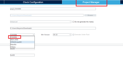

PS:
@johannv99 wrote:
Toolchain / IDE EWARM
your example has : STM32CubeIDE
You can regenerate the code I've attached previously to generate EWARM project:
Hope it helps.
