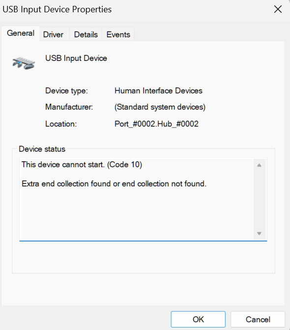

I am trying to test a CustomHID from the STMCubeMX code and the project does not seem to work as intended.
When I use the HID Standalone example for the STMH735G Dev Kit the project works as intended however when I try to set it up with the CustomHID windows gives this error. I changed the clocks to match the HID Standalone project with a max clock of 520mhz.
Wondering what I am doing wrong or if there is some setting that needs to be modified for this to work properly. Looks like everything is setup and should work already but doesn't

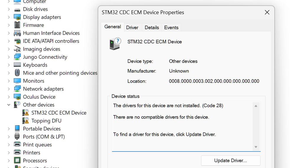

still receive code error 10
when attempting the CDC example for AzureRtos
I get this, I dono if this is helpful information to resolving this.
