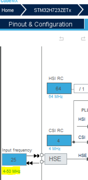

In clock configuration for STM32H723ZET the oscillator input is limited to 4-48MHz.
The datasheet says 4-50MHz.
I'm using a 49.152MHz oscillator in bypass mode and this results in a clock tree error.

Good news :smiling_face_with_smiling_eyes: I am pleased to inform you that this issue is fixed in the latest STM32CubeMX version 6.3.0.
Now, CubeMX is showing the correct oscillator input limits matching values in the datasheet :
Thanks for your contribution.

Normally, DS is the authoritative information source, so you can ignore any constraints of CubeMX or any "library".
