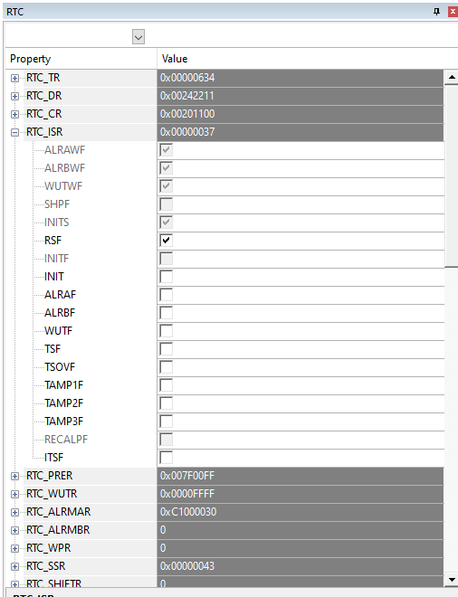

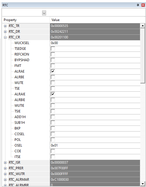

All necessary bits are set
OSEL = 01 ALARM A
RTC_OUT_RMP = 0 NO REMAP (PC13 OUT )
RTC_ALARM_TYPE =1 PP MODE .

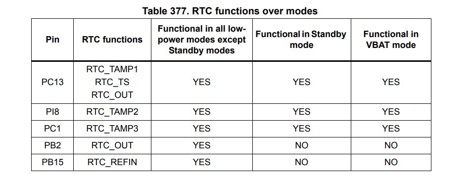

But whether it should work in active mode, this table does not say anything about this.
