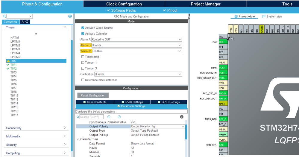

I'm trying to get an alarm signal on an external contact (PC13). In the program everything works as it should and the interrupt occurs, but nothing changes on the external contact. What did I miss?

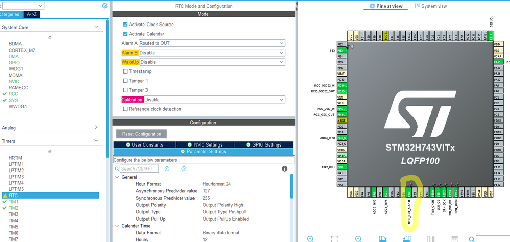

I make the settings in the cube, and the pc13 pin is automatically configured to RTC_OUT_ALARM. Or is something else required?
2024-02-12 4:32 AM
I switched the signal output to PB2 and still nothing changes, the interrupt is triggered but nothing is output to the external pin. I don’t know what to do

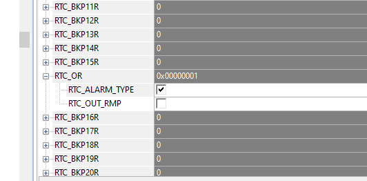

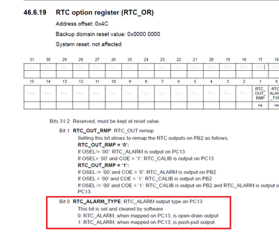

What about the bit value of RTC_ALARM_TYPE in RTC_OR register? is it configured in Open drain mode (value 0)? in that case you will not see anything on the pin.
2024-02-12 8:53 AM
Also did you connect VBAT to VDD? PC13 is supplied from VBAT if VDD is lost.
2024-02-12 9:12 AM
The output is configured as push-pull. Vbat and VDD are different sources and are not related to each other.
