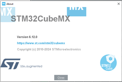

2024-07-17 12:52 AM - edited 2024-07-17 12:55 AM
Hello @VO ,
This issue is fixed in STM32CubeMx6.12.0 as mentioned in STM32CubeMX errata 6.12.x - stm32mcu
I tested the code generation with STM32CubeMX with STM32H743AGI6 a version 6.12.0 on Windows and didn't reproduce the issue. Please make sure that you that you use the last version of STM32CubeMX.
May this post help you!
Could you please share your ioc file?
Thank you.
