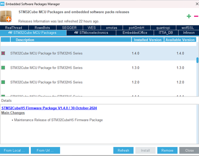

I do not know how to revert a project to an earlier CubeMX and FW version. Using STM32CubeIDE v1.17
2025-02-07 11:00 AM - edited 2025-02-07 11:02 AM
go : menu -> help -> configuration tool -> manage embedded...
then:
select (green button) to delete...and select other version -> green = active is the most recent/newest.

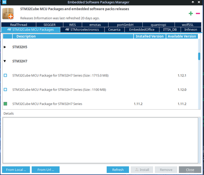

btw
You see, i still use 1.11.2 H7 - why should i update, if everything i use is working fine ?
Just to find new errors...?
2025-02-07 11:41 AM
I had to update to get correct VREFBUF handling for H563.
Deselecting H5 1.4 won't affect existing project. From what I've seen, this is only used when a project is created. The only H5 1.4 options are Refresh and Remove...
2025-02-07 11:57 AM
So you need to use v 1.4 ? (as i understand it...)
try: open Mx view, then generate code . -> compile and check it...

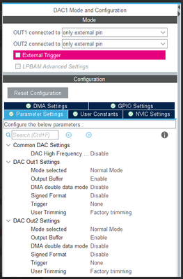

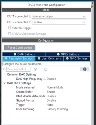

2025-02-13 7:56 AM
CubeMX 6.13 DAC1 configuration...
CubeMX 6.12 configuration...

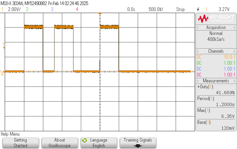

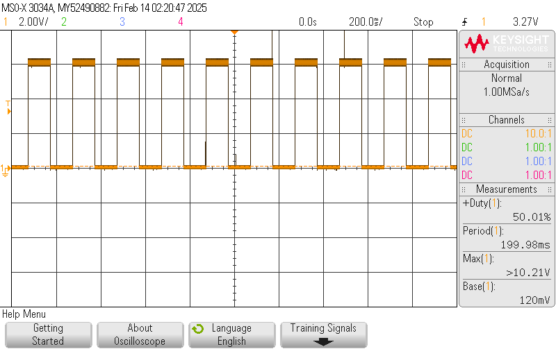

2025-02-13 9:22 AM
Good DAC output...
Bad DAC output...
Amplitude is ~6v because of an op-amp downstream of the DAC1 channel 1 MCU pin. Scope trace taken at the MCU pin looks the same, except amplitude is ~2.5v.
