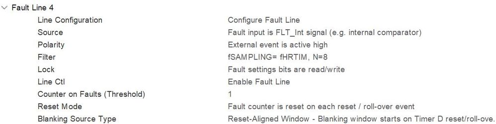

I tried to do a lot of changes of configuration,but it didn’t work. when I use comparator output as FLT input pin,fault protection works,however it‘s used as FLT_Int signal,it always doesn’t work.
Hope your kind help,Thanks!

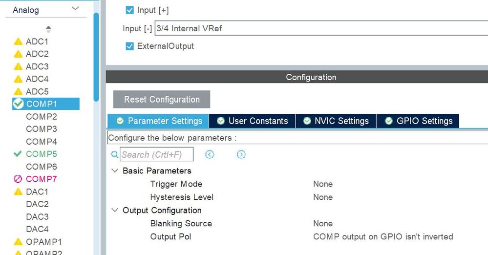

Hello
I think you have to fill the "Trigger Mode" of your comparator with an Event (and not an interrupt) :
