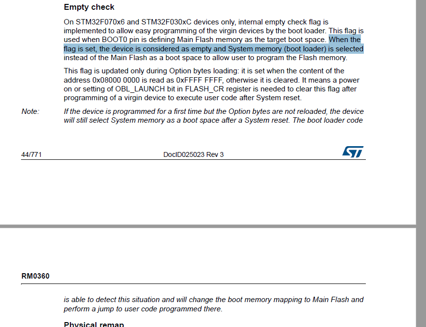

What I found is that the SYS_CFG.MEM_MODE register == 1 (which is system flash, not Main flash)
So I hand edited register and set mem_mode=0 and fianlly we got interrupts calling the irq vectors as expected.
The MEM_MODE register is supposed to configured by the BOOT0 pin which is tied low. BUT there is a an empty check
So this maybe a hangover with using emulator, but for now I have to manually reset this to 0 to set main flash memory.

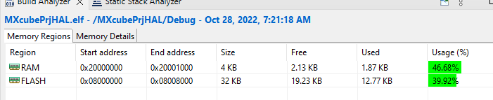

How much RAM does your program use? HAL code requires more RAM than LL.
The DS says it has only 4 KB (page 10, table 2) which is er....tight.

Hello @RMurt.3
As @Pavel A. mentioned this MCU have a small RAM and Flash with 4KB for RAM and 32KB for FLASH also the fact that the HAL require more memory space than the LL.
The build analyzer tool in CubeIDE give you an estimation about the memory use.
You can work with the LL driver or try to use (-Og) optimization level when compiling the code.

2022-10-27 11:30 AM
Thanks for feedback.
I added a snapshot of memory footprint which does not seem to be be stressed to much.

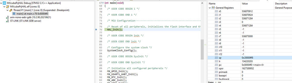

2022-10-27 12:32 PM
@start stack is 0x20000ff8
If I run it the stack is now 0x20000fa0
Trying to find documentation on stack location and size now.

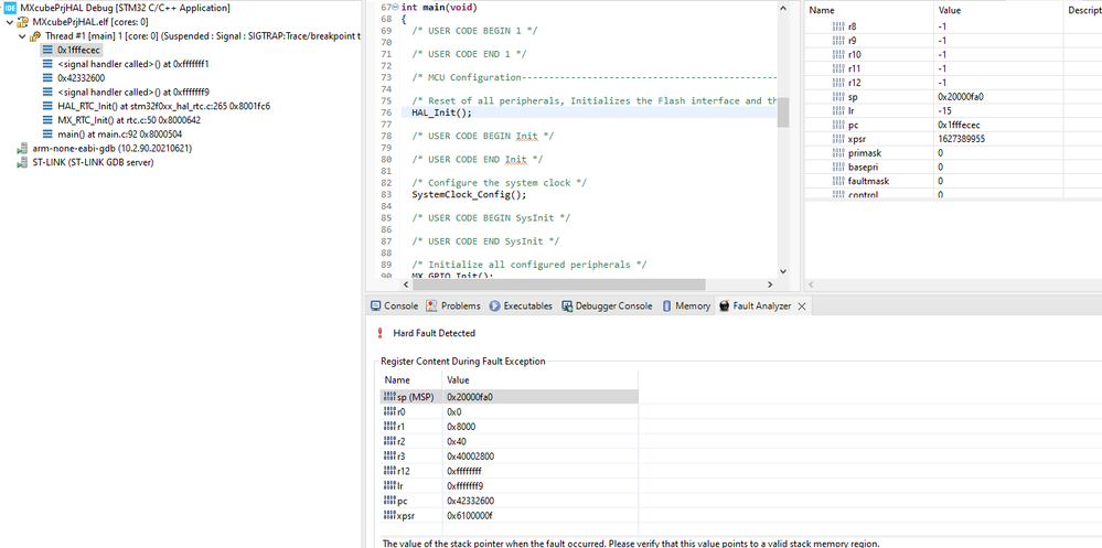

2022-10-27 2:02 PM
Please show more of the fault analyzer info.
The stack location and size is defined mainly by the link script. The initial value of the sp looks good. But the PC at the point of fault is bad (42332600)
2022-10-27 4:09 PM

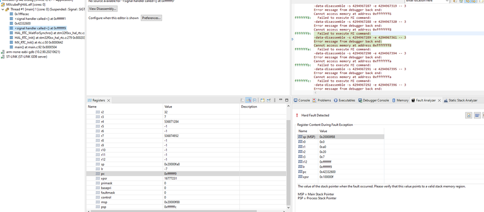

Hi Pavel, thanks for your reply.
It seems the PC goes west just after this function call
When we get the first interrupt @ Sig int handler 0xfffffff9
Im not sure what to make of that but I think that is the hardfault??

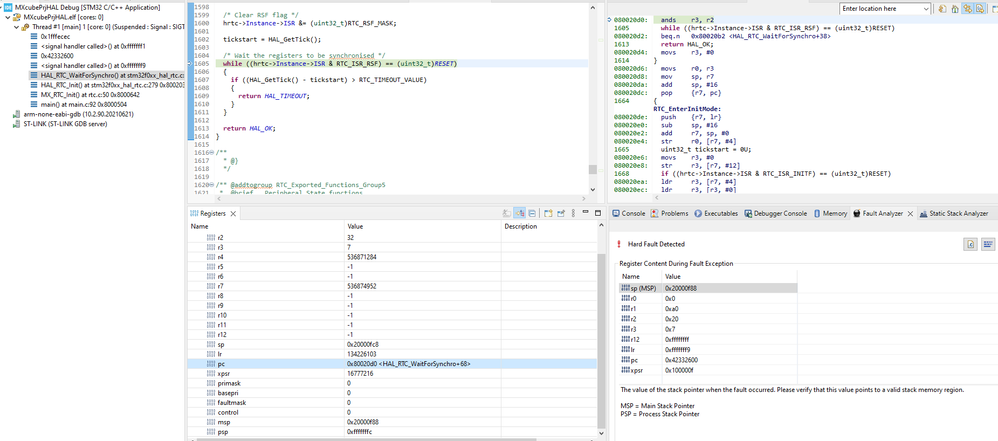

The SFR may be showing me the final state and not when the RTC init was executing
Another observation I have made is that if I just RUN then it gives me the error shown above
But If I single step through the MX_RTC_Init() it is all good and It crashes when it tries to go into the MX_ADC_Init()routine. Maybe there is something about the emulator or an optimisation that makes it look like the error is on the adc call.
