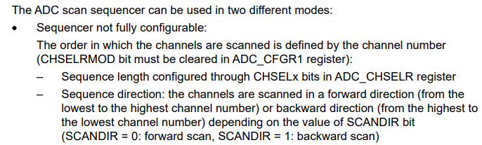

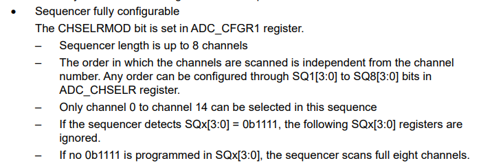

You are proberly still in normal mode and not in legacy mode.
If you configer the ADC to "not fully configurable" you can use ADC_IN15&16&17
I hope this helped!

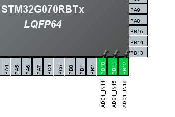

2023-04-18 7:13 PM
Hi
Just open a new project with the STM32G070RB device selected.
click on PB10 to select ADC1_IN11 to turn green
click on PB11 to select ADC1_IN15, and PB12 to select ADC1_IN16 both turns yellow.
Here is the screenshots and ioc file in zip.
01 and 02 pictures shows the hovering at PB10 (green- ADC1_IN11 (IN_11)), and PB12 (yellow _ ADC1_IN16 (no mode)).
The centre panel-ADC mode and configuration, shows ADC configuration with IN15 to IN18 grey out ???

2023-04-19 12:23 AM - edited 2023-11-20 7:49 AM

2023-04-19 12:42 AM
Thank you for the reply, That seems to solve the problem. It is really hidden in the reference manual that is not easy to spot.

2023-04-19 12:49 AM - edited 2023-11-20 7:50 AM
No problem
Took me a while to find it! hope it helps you and more people!
!!Source RM0454 section 14.3.8 page 284 and 285
--Not fully configurable--

2023-04-19 1:10 AM
By the way, a newly created project should have the default of 0 for CHSELRMOD bit if not explicitly configured, which means the default is "Sequencer not fully configurable" and should have the green for both PB11 & PB12 though. But this is not the case.
