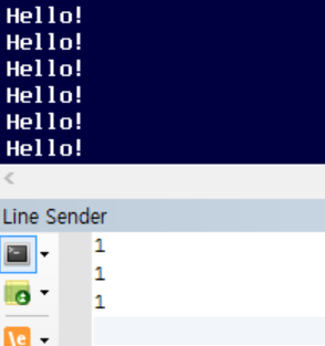

I want to get UART Interrupted data to vary LED blinking speed.
For example,If I send 1 then speed 100ms or send 2 then speed 200ms.

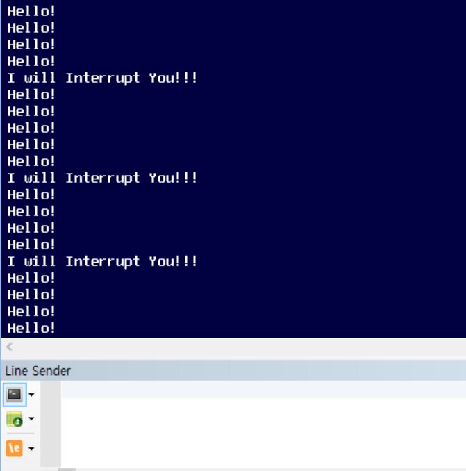

I made a cod using CubeMX and Interrupting with just pressing ''Enter'' works perfect(Not sending any data)
(I pressed ''Enter'' 3 times in Line Sender)

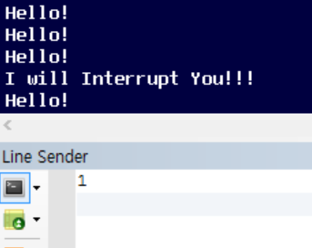

but If I send some character like below, It iterrupts just one time and never interrupt again with my further interrupt action.
Here is my Code.

Do you have any idea what went wrong here?
