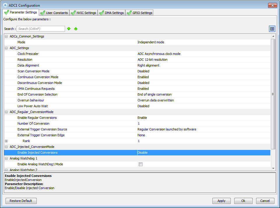

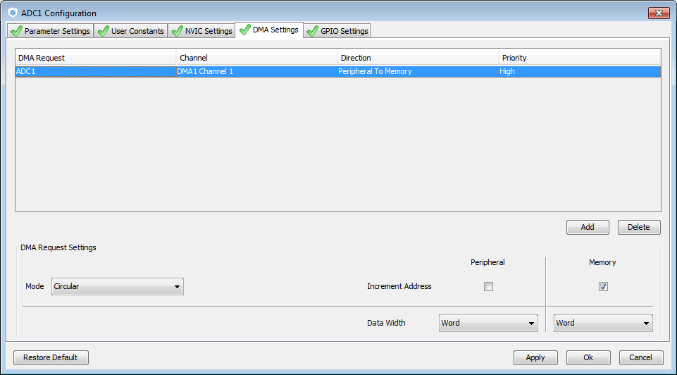

I have setup the STM32CubeMX project.. (STM32F302RExx)
I use the ADC in continues / scan mode.
I have DMAContReq = true..
I then setup DMA on ADC1-CH1 with HIGH prio..
but when i generate my Cube-code... i don't see ANY code for the DMA setup ??

I'm guessing i am missing something like THIS (THIS IS NOT TO FIND IN CUBE-GENERATED CODE):
hdma_adc1.Instance = DMA1_Channel1;
hdma_adc1.Init.Direction = DMA_PERIPH_TO_MEMORY; hdma_adc1.Init.PeriphInc = DMA_PINC_DISABLE; hdma_adc1.Init.MemInc = DMA_MINC_ENABLE; hdma_adc1.Init.PeriphDataAlignment = DMA_PDATAALIGN_WORD; hdma_adc1.Init.MemDataAlignment = DMA_MDATAALIGN_WORD; hdma_adc1.Init.Mode = DMA_CIRCULAR; hdma_adc1.Init.Priority = DMA_PRIORITY_HIGH; if (HAL_DMA_Init(&hdma_adc1) != HAL_OK) { Error_Handler(); }__HAL_LINKDMA(&hadc1,DMA_Handle,hdma_adc1);

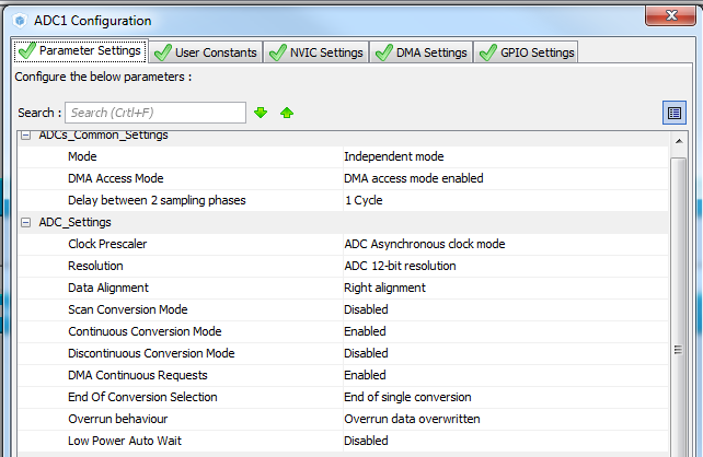

2017-01-19 12:41 AM
Hi
,Using :
all work as expected and theHAL_ADC_MspInit is generated correctly :
void HAL_ADC_MspInit(ADC_HandleTypeDef* hadc){ GPIO_InitTypeDef GPIO_InitStruct; if(hadc->Instance==ADC1) { /* USER CODE BEGIN ADC1_MspInit 0 */ /* USER CODE END ADC1_MspInit 0 */ /* Peripheral clock enable */ __HAL_RCC_ADC12_CLK_ENABLE(); /**ADC1 GPIO Configuration PA0 ------> ADC1_IN1 PA1 ------> ADC1_IN2 */ GPIO_InitStruct.Pin = GPIO_PIN_0|GPIO_PIN_1; GPIO_InitStruct.Mode = GPIO_MODE_ANALOG; GPIO_InitStruct.Pull = GPIO_NOPULL; HAL_GPIO_Init(GPIOA, &GPIO_InitStruct); /* Peripheral DMA init*/ hdma_adc1.Instance = DMA1_Channel1; hdma_adc1.Init.Direction = DMA_PERIPH_TO_MEMORY; hdma_adc1.Init.PeriphInc = DMA_PINC_DISABLE; hdma_adc1.Init.MemInc = DMA_MINC_ENABLE; hdma_adc1.Init.PeriphDataAlignment = DMA_PDATAALIGN_HALFWORD; hdma_adc1.Init.MemDataAlignment = DMA_MDATAALIGN_HALFWORD; hdma_adc1.Init.Mode = DMA_NORMAL; hdma_adc1.Init.Priority = DMA_PRIORITY_HIGH; if (HAL_DMA_Init(&hdma_adc1) != HAL_OK) { Error_Handler(); } __HAL_LINKDMA(hadc,DMA_Handle,hdma_adc1); /* USER CODE BEGIN ADC1_MspInit 1 */ /* USER CODE END ADC1_MspInit 1 */ }}�?�?�?�?�?�?�?�?�?�?�?�?�?�?�?�?�?�?�?�?�?�?�?�?�?�?�?�?�?�?�?�?�?�?�?�?�?�?�?�?�?�?�?�? -Nesrine-
2017-01-19 1:51 AM
hmm... now thats looks funny...
try CubeMx 4.19
and I DON't generate code in seperate C/H files..
but have it all in 1 Main.c
I'm Generating Code UPDATE the code, because i have added own code..
/M

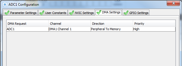

2017-01-19 2:48 AM
Hi
Holch.Mikkel
,I'm using the 4.19 version,
the ADC
MSP Initialization with DMA configuration isavailableon
stm32f3xx_hal_msp.c file.
The MSP file ( located in your project Src folder) is generated automatically.
-Nesrine-

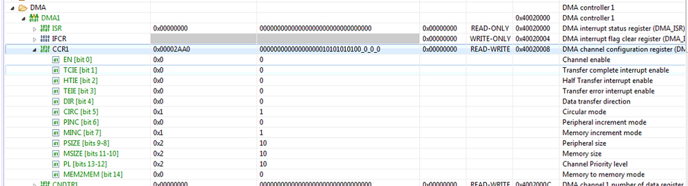

2017-01-19 4:28 AM
Ahh... Thanks..
Found the File. and now it makes more sense (also GPIO alternative function setup)
That is the CodeGeneration Part.
I can debug that the Code is being run, and the DMA is setup according to CubeMX Spec.
but then I don't know why it is not working.
Do you have to manual start DMA initially ?
HAL_ADC_Start(&hadc1);
uint32_t g_ADCBuffer1[16];
HAL_ADC_Start_DMA(&hadc1, g_ADCBuffer1, 16);
If I do a Poll on the ADC i Read what i expect..
Does this look correct setup ? EN = 0 ??
