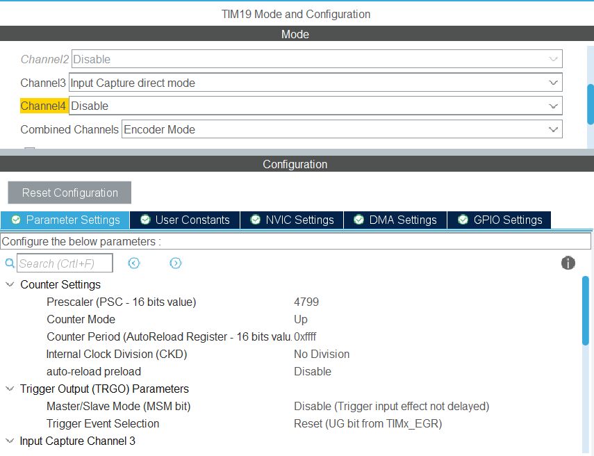

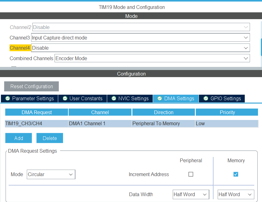

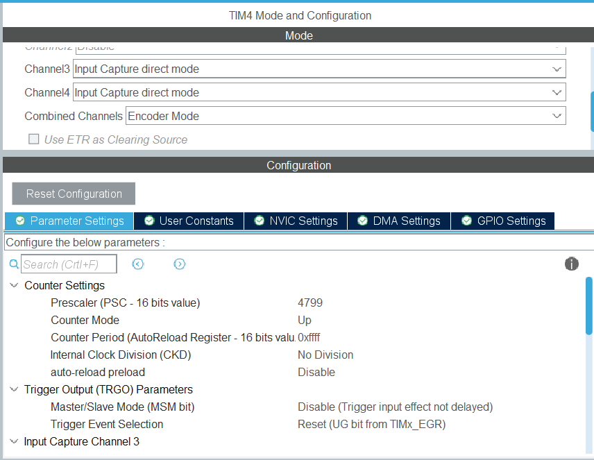

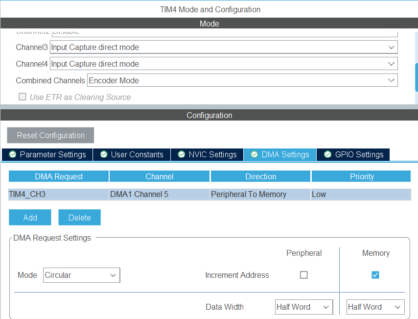

I have a STM32F373 processor and I have 2 Encoders and 3 Input Captures.
I have enabled DMA for input capture.
Timer 4:
Timer 19:
And I have this code.

Yes.
IC will capture the CNT value at the time of the event, which is then transferred by DMA.
2021-08-07 12:18 PM
So in this case, combining Encoder with IC....bad idea?
Do you have another solution?
I think I need to have DMA because if I using interrupts, then the interrupts will...well...interrupt other parts of the code.
2021-08-07 12:23 PM
2021-08-07 12:26 PM
Why does it not seems useful? Encoder + IC?
I'm using IC because I want to measure frequecy.
I'm using encoder because I want to measure position.
2021-08-07 12:35 PM
Use one timer for the encoder and use another timer to measure frequency.
It may be possible to hook up IC to transfer the CNT value from another timer instead, but it's probably not something that HAL supports out of the box.
