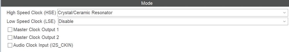

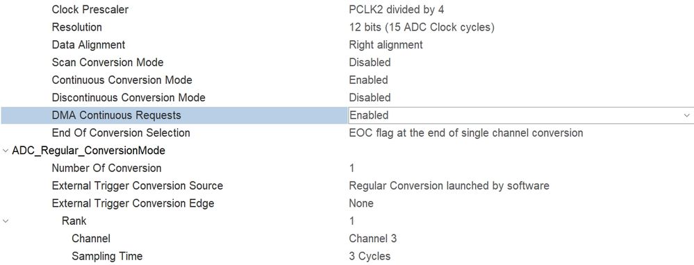

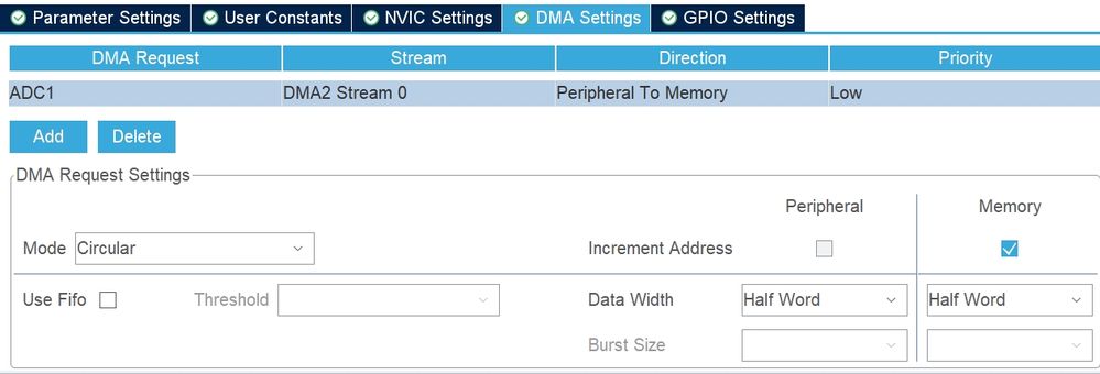

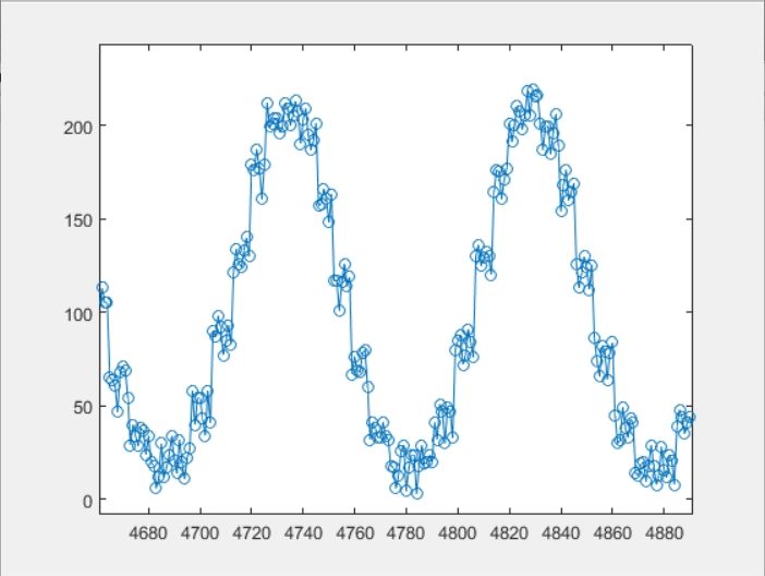

Stm32f407ve used ADC+DMA used 1KHz sin is not read evenly when reading the reason

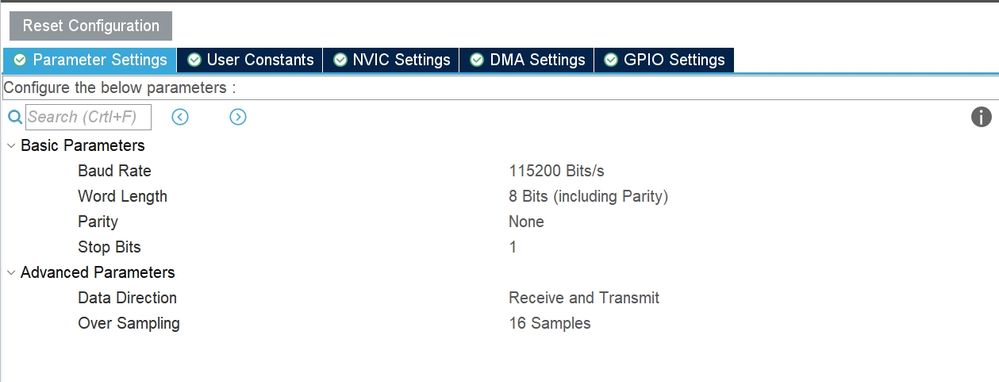

External 8MHz crystal and UART asynchronous use

You don't look to be pacing with a TIM, assume that you are saturating the USART.
