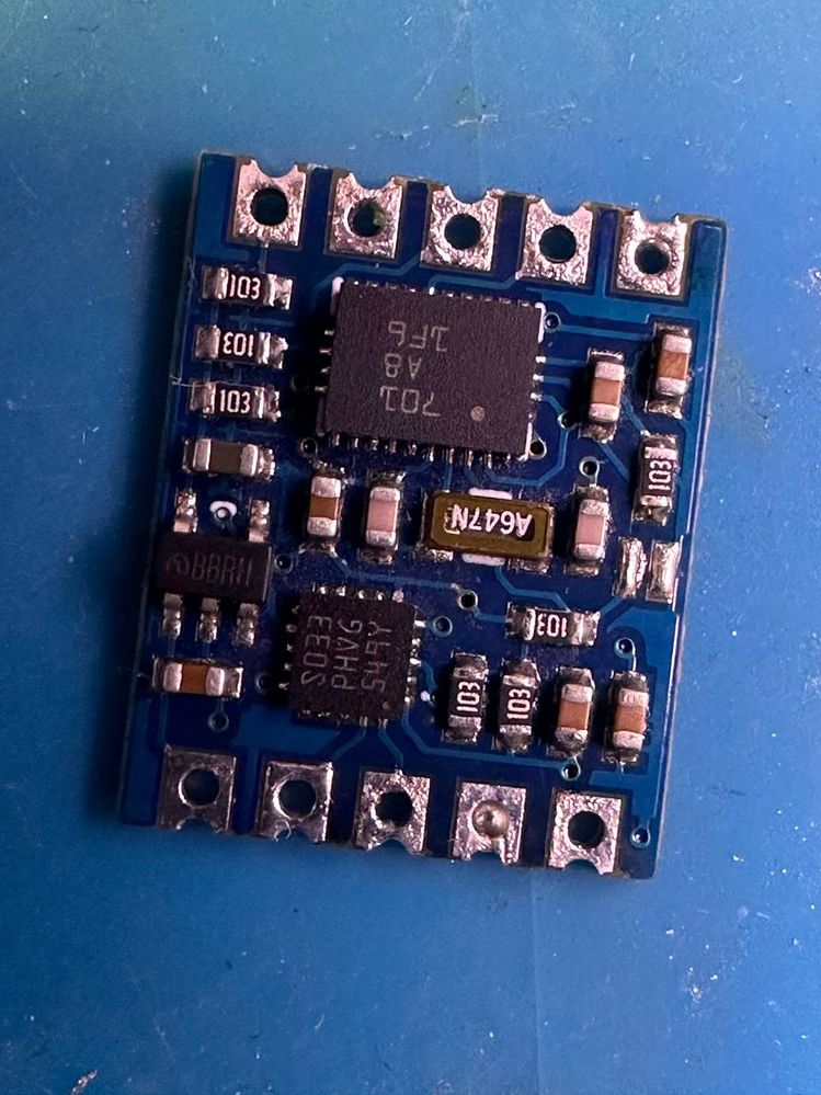

And this photo that I mentioned is our BNO055 module:

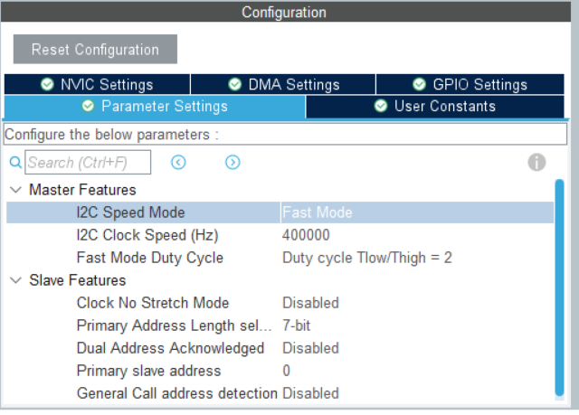

Also, I configured the I2C2 with the following details:

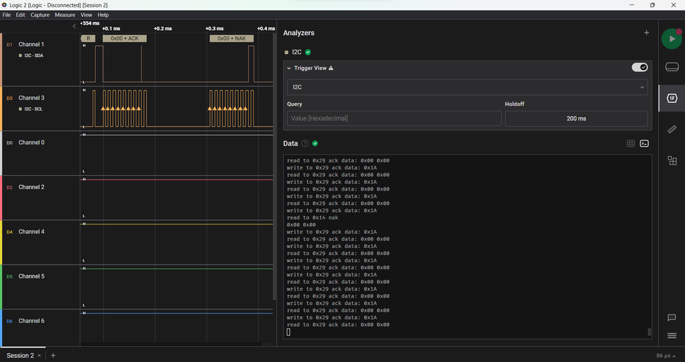

2023-04-08 4:44 AM - edited 2023-11-20 8:44 AM
Thanks for your responsing, we check our I2C lines with logic analyzer device and we tested our I2C lines when the I2C start and our module sent data but suddenly after many reset the microcontroller, I2C did not start anymore and we must to turn off the power and back on to working again.
Is there any way to find out our I2C start well or not?
However, we suspect that both SCL and SDA lines remain high or low and don't let MCU start I2C.
Here is our data log before this happens:
Also we check (HAL_I2C_GetError) and always returns zero
