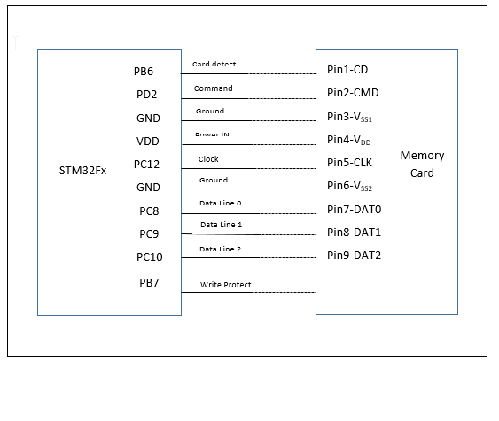

Hello. I am trying to integrate SD Card (Transcend 4GB) with STM32F407 Disc board. I had followed all previous discussion & made corrections yet i am getting Error. I have attached my clock configuration, Pin diagram of STM Cube MX & Detail Code. Can anybody tell me what extra changes i Need to do to get rid of error. Usually i am getting Disc error (Program is not going aheaf 'f_mount()'). When i press reset button it gives Disc Error.
I changed all GPIOs to 'Pull high'. I am not sure if 3V power is enough for the Memory Card as i am directly connecting my VDD pin (STM32F4) to Memory Card. I have connected Memory Card by following way to board:
1. Card Detect (PIN1) to PC2
2.CMD (PIN2) to PD2
3. Clock(PIN5) to PC12
4. VDD(PIN4) to 3V
5. DAT0(PIN7) to PC8
Any comments about Code & configurations will be highly appreciated.

Don't think you've quite grasped the Card Detect here. If you are running in SDIO mode, vis SPI.
The Card Detect on a socket is typically a switch to ground, not a card pin. If a card pin it is used as a Chip Select.

Do you have the Ground pin (3 & 6) wired?

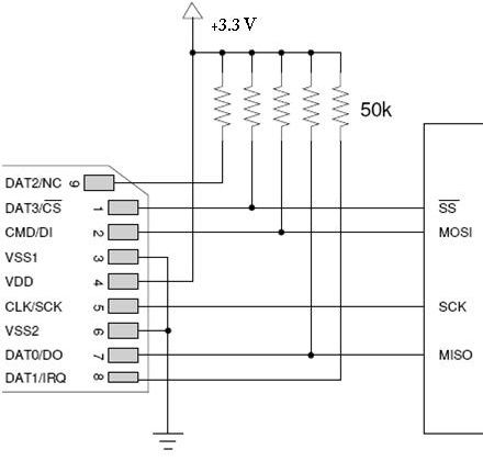

An SPI type connection would look something like this
I'd recommend a fully wired SDIO solution, look at the STM32F4DIS-BB board for a common and working interface.

2. Yes i am using socket. I have soldered Pins with socket. Please find attached Information of same. It have 9 Pins which i have connected with Discovery board via connectors.
http://www.molex.com/molex/products/datasheet.jsp?part=active/5035000991_MEMORY_CARD_SOCKET.xml
3. Yes i have wired Ground Pin 3,6 & connected it with GND terminal on the Discovery board.

Problem solved. I guess error was in Clock Initialisation for SDIO. I think when i generated Code from cube MX, clock initialisation was Missing. Also I have assigned seperate pin for Card detect (PE15 for STM32F205). SO now i can detect my SD Card as well as write data on it.
