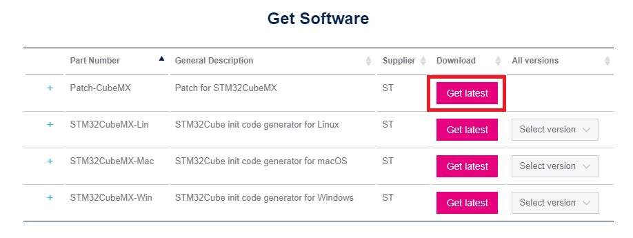

2023-01-08 12:58 PM
Dear Piranha,
You are right, the link bring to STM32CubeMX page.
Once on it, you need to download the patch as indicated below.
