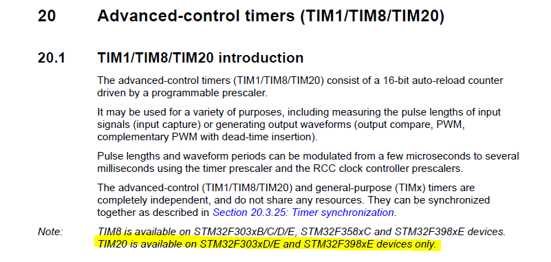

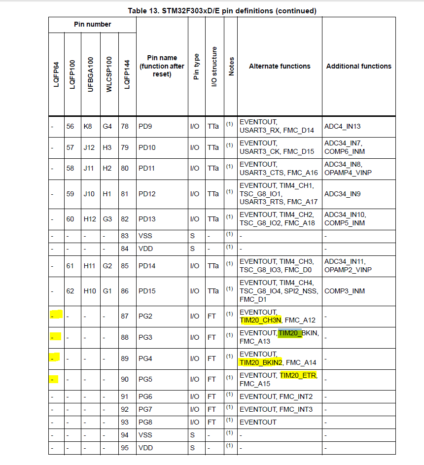

STM32F303RE belongs to the package LQFP64
TIM20 is well suited for all 303xD/E that have at least 100 pins ( so not 303R--). So, in the datasheet you must be able to find that TIM20 is not there on the 64 pins.

Hi @CGAIR
TIM20 is available on STM32F303xD/E and STM32f398xE devices only.

2019-05-15 4:58 AM
Look for example:

2019-05-15 5:27 AM
I guess, TIM20 is still there, it's just that it has no pins brought out.
