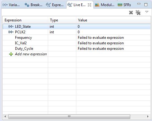

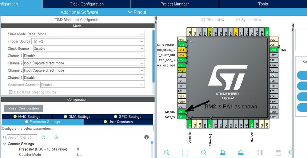

The TIM2 setup within MX is:
The "Live Expression" window is a shown:
I added the PCLK2 HAL READ and LED_State to make sure I am using the tools correctly. These variables
are working fine in Live Expression.
A little professional help here would be highly appreciated.
Please take a look and see what is stopping these variables from being processed and viewed.
Thanks
