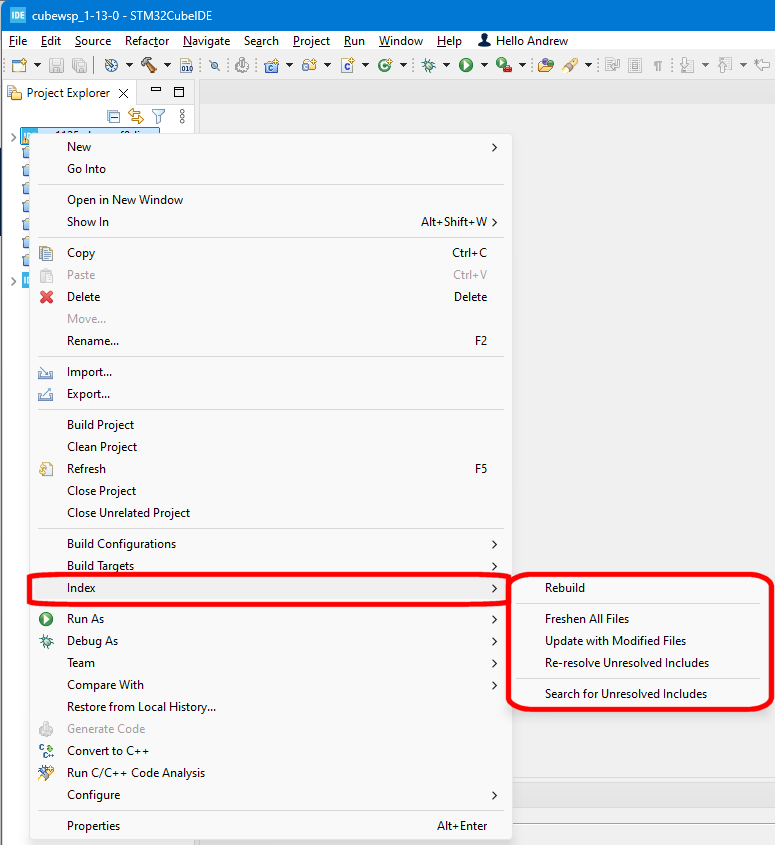

2024-11-18 1:18 AM - edited 2024-11-18 1:21 AM
@Wan_G wrote:There are no errors during the compilation, but when I write the code, the auto-completion feature does not work .
So the problem is just in the Editor - not in the compiler configuration.
You haven't said what IDE you're using. For STM32CubeIDE, try rebuilding the index:
