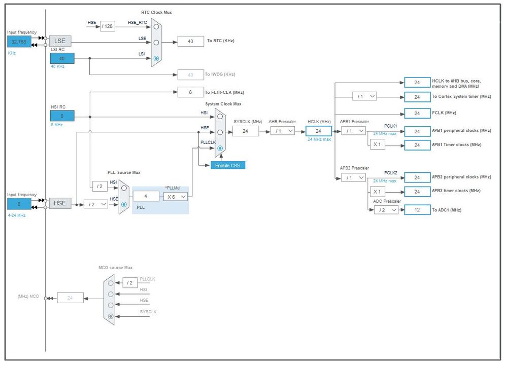

I'm using the STM32F100RB , mounted on the STM32VL Discovery board.
The clock confioguration, done in STM32CUBEMX is supplied at the end of the post.

The STM32CUBEMX Clock Configuration. is attached below.

2019-07-02 8:14 AM
LSI is innacurate. Use LSE for RTC.
2019-07-02 10:12 AM
Thanks!
I switched to LSE for RTC.
There was indeed an improvement. The Actual Time and RTC Time seem to be in a volatile lockstep (I will run it for a while to make sure).
HAL_GetTick also showed improvement. however, it seems to add 1 ms for each 10 seconds. If I'm not using it for RTC milliseconds, it's quite good.
Follow-up: I ran it for an hour. It's stable. 1 RTC second is 0.999972316 actual seconds, and HAL_GetTick second is 0.9999096 actual seconds.
