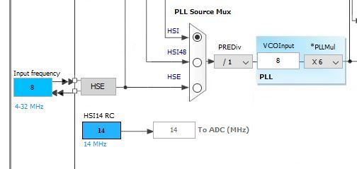

I have a custom PCB with a STM32F042F4P6.
The STM32 keeps resetting at a rate of 2.5 Hz. I measured this with a scope on the NRST pin.
After a long search i found out that the IWDGRSTF flag is set after each reset. This is strange, because i never enabled the IWDG or WWDG in CubeMX v4.23. I also do not see anything about a set up of a watchdog in the generated code. Further, after i erase the chip in ST-Link utility, the STM32 is still resetting (at a constant rate of >600hz).

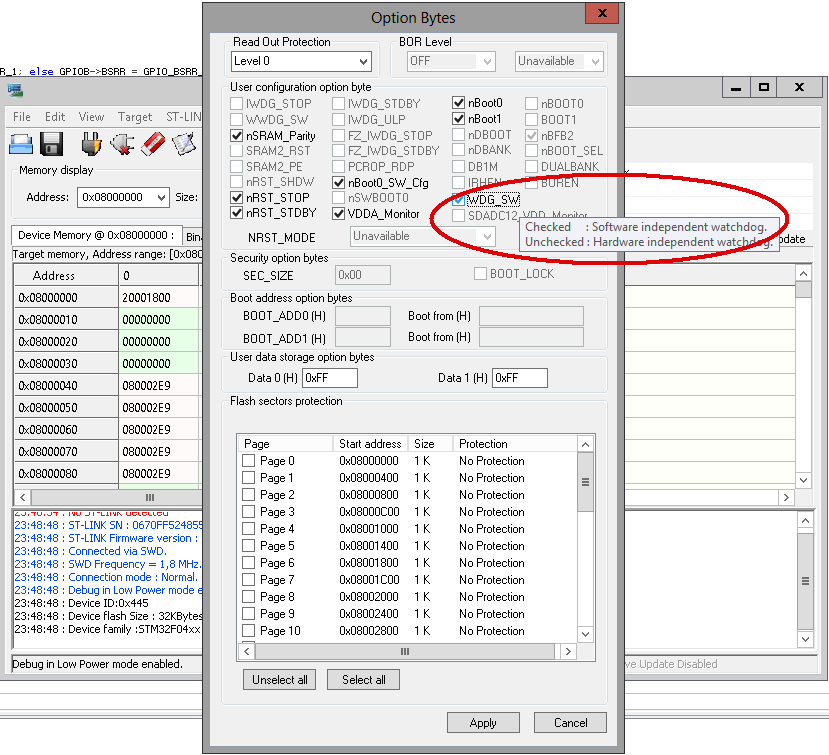

Attached a screenshot of the IWDG and the CSR register.

''Hardware watchdog'' enabled in options?
2018-07-01 7:58 AM
Thanks, it was indeed not checked. Now the NRST pin is not triggered anymore while program is running.
But i get error message in System Workbench, if i try to program/debug: 'Error erasing flash with vFlashErase packet'
It is still possible to program with the ST-Link Utility. It then show that the MCU Core is Running.
My program toggles a LED in a while loop. This doesn't happen, so i think it is stuck again in the infinite loop.
2018-07-01 9:04 AM
I don't use System Workbench.
Generally, you can't have simultaneously connected STLink-Utility and the IDE.
Also, check all other option bits. The WDG-SW in a fresh chip is not set to 'hardware' watchdog, so some of the tools you are using has set it - and I'd suspect the IDE first. Thus it might have set other unexpected option bits, too.

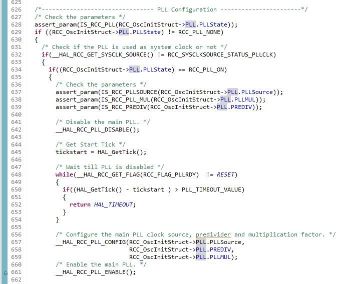

STM32 still resets..
This happens after executing ''__HAL_RCC_PLL_ENABLE();''
Does not matter if HSE or HSI is selected as input source of PLL. Without using PLL, STM32 runs fine.
