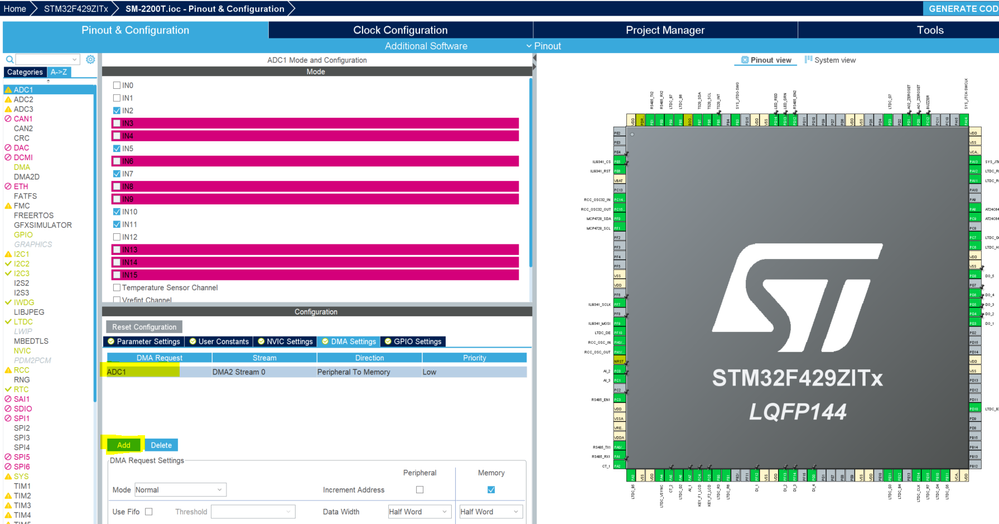

2019-10-29 1:30 AM
Hello @HJung.6 ,
You need to Add first " DMA Request " under DMA Settings and then you can enable the "DMA Continuous Requests".
Regards,
Khouloud.
2019-10-29 1:33 AM
Issue already fixed, You have a missed config in your project.
Please Add " DMA Request " under DMA Settings .
Regards,
Khouloud.

2019-10-31 6:07 PM
you're right. so sorry it is work!
