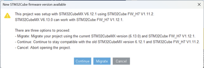

I recently updated my version of CubeMX from 6.12.1 to 6.13.0. It is now unable to open my .ioc for a specific STM32H563VI project.
When I try to migrate, it loads the IOC, then gives an error saying it is "Not a valid ioc file".
If I try to continue using the old version, it gets stuck on unzipping a file (DB.6.0.121.tar.bz2) for a few minutes, then silently stops.

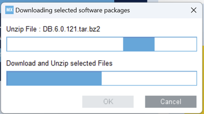

I have the same problem.
It gets stuck here and, after a few seconds, gives up.
