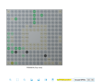

I recommend you to refer to the STM32U5A datasheet and precisely Table 27. STM32U5Axxx pin/ball definitions and check whether you are able to map all OCTOSPIM signals to port G or not??
For example,  OCTOSPIM_P1_CLK signal is not available on port G.
Also you can used search method to find the availability of signal on different pins as shown in the below figure

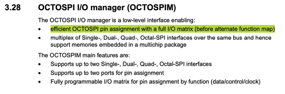

It appears that it is not possible when reading Table 27. However, that means that the text in para 3.28 is a bit misleading:
Since we consequently are forced to run the entire CPU on 1V8, is it correct that we can run the OSPI clock at 93MHz in both SDR and DDR mode, effectively reaching 93MT/s and 186MT/s with 8 lanes? It looks possible to me from the data sheet, but I might have overlooked something.

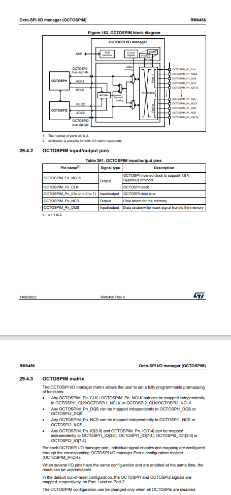

Hello @MikeStrom,
The OCTOSPI I/O manager is a low-level interface that enables an efficient OCTOSPI pin assignment with a full I/O matrix (before alternate function map) and multiplex of single/dual/quad/octal SPI interfaces over the same bus.
That means the OCTOSPI I/O manager matrix allows the user to set a fully programmable premapping of functions:
• Any OCTOSPIM_Pn_CLK / OCTOSPIM_Pn_NCLK pair can be mapped independently to OCTOSPI1_CLK/OCTOSPI1_NCLK or OCTOSPI2_CLK/OCTOSPI2_NCLK
• Any OCTOSPIM_Pn_DQS can be mapped independently to OCTOSPI1_DQS or OCTOSPI2_DQS
• Any OCTOSPIM_Pn_NCS can be mapped independently to OCTOSPI1_NCS or OCTOSPI2_NCS
• Any OCTOSPIM_Pn_IO[3:0] and OCTOSPIM_Pn_IO[7:4] can be mapped independently to OCTOSPI1_IO[3:0], OCTOSPI1_IO[7:4], OCTOSPI2_IO1[3:0] or OCTOSPI2_IO[7:4]
For more information, I recommend you to look at RM0456 and precisely section 29.4 OCTOSPIM functional description
This sentence means that it’s possible to use OCTOSPIM pin port 1 for OCTOSPI2 and OCTOSPIM pin port 2 for OCTOSPI1.
