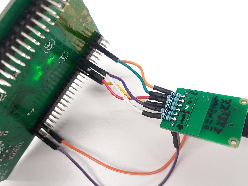

Please can you post the Image of other side of the sdcard board for Soldering reference .also please share the working code since i have been trying from past 3 weeks.(STM cubemx+Truestudio9.1)

Dear Ashwinraj,
Please refer to following URL and picture.
https://github.com/jason0627/STM32F4-Discovery_SDIO_4bit_OK
Best regards,
Jason

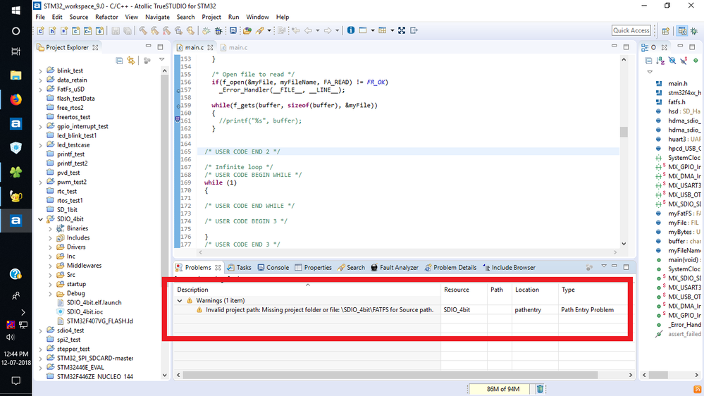

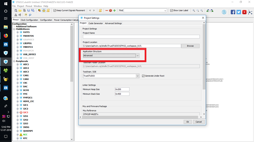

3) In cubemx change the application structure to Advanced(check attach image) or else in truestudio you will get path entry warning
2018-10-03 1:43 AM
