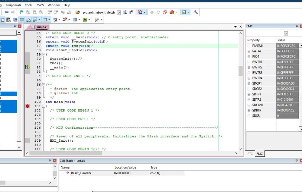

2021-04-22 7:08 AM
Hello Rajeev
Since inside "startup_stm32h753xx.s" Reset_Handler is defined as WEAK, you can define a new startup sequence with HAL like the picture below that initializes external SDRAM .

2021-04-26 2:07 PM
Hello @Rajeev Arora
in startup_stm32h753xx.s line 239 Reset_Handler is weak so the programmer has the freedom to define his own Reset_Handler. (like the picture above)
