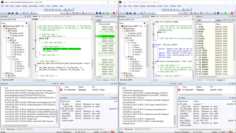

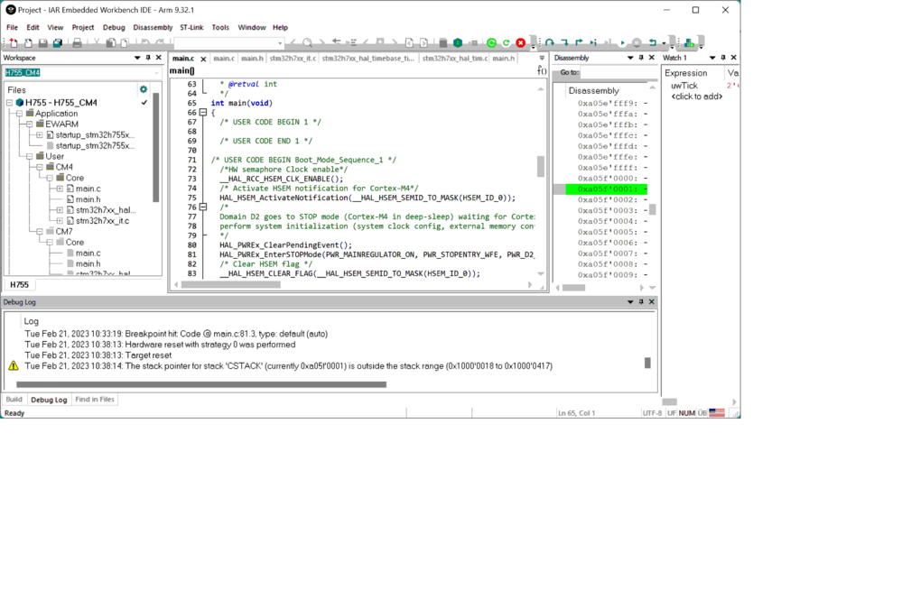

Within the IAR and without a breakpoint, I got what can be seen in the attachement.

Note that, CM4 program will be copied by CM7 program. So, after booting sequence of each core, you can add breakpoint and debug your code. Otherwise, a warning of stack outside the range is fired since the memory is corrupted. After that, the debug fails.

M4 => RED Led with 10 Hz, works if started from the debugger and a first stop at the breakpoint
M7 => GREEN led, works always
