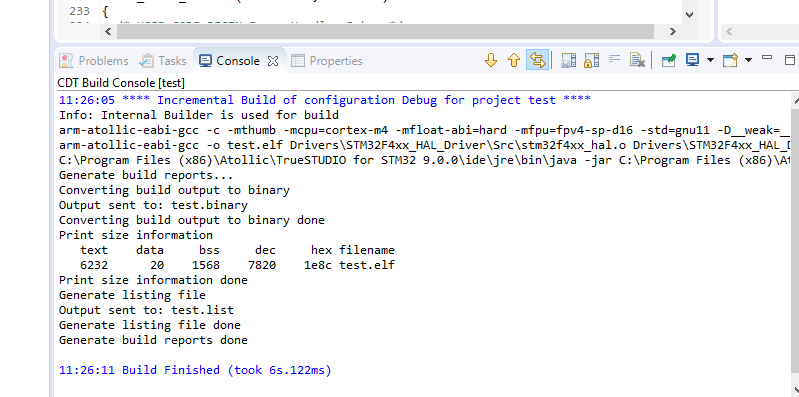

#atollic #truestudio #code-generation #stm32cubemx #generator #bug2018-02-20 12:32 AM
I've tested it for a simple application, and the compilation was successful.
There may be another problem.
2018-02-20 4:03 AM
Hi
hsenani
,I tried to reproduce your issue, but the compilation was done successfully and the needed third party files were generated under 'Middlewares\Third_Party' folder.
For further investigation, you may share you 'ioc' file.
Khouloud.
