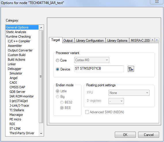

Hello Rob,
the problem is that the IAR doesn't know the STM32F071C8 device.
To fix this you need to configure STM32F071CB device in the project settings. It is the same device, but with more flash memory.
Best regards,
Adam Berlinger
