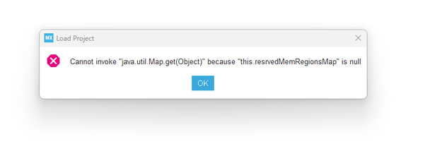

My STM32CubeMX crashes randomly. I've attached the ioc file so you can run some tests and see for yourself. I tried to make some changes to my original project, and as I reopened the ioc it came up with this message:

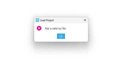

After that, I created a new project and was able to change things around until I activated the XSPI1 and XSPI2 with the Memory Manager and the Memory Loader. After those changes, I got this message:

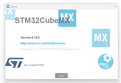

My STM32CubeMX version is:

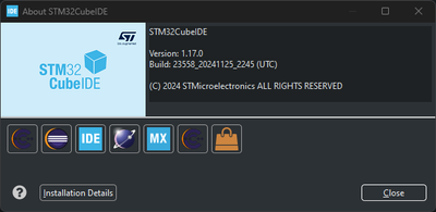

My STM32CubeIDE version is:

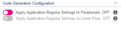

MMTConfigApplied=falseAfter one goes into Tools --> Memory Management settings and turns on the two switches in Code Generation Configuration.
If you go into the IOC file and delete all the "MMTApp" stuff, STM32CubeMX will usually start. However, all your memory settings will be lost. If you try to activate those switches again, the same thing happens.
