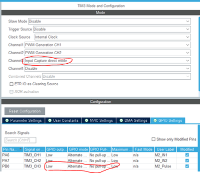

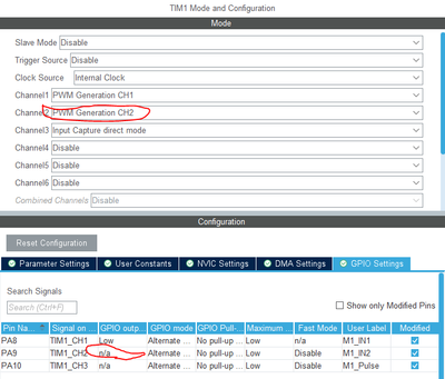

I have changed chip to STM32G030C8T6, because STM32G030F6P6 cannot use HSE.
but for STM32G030C8T6, the cubeMX is also something strange.
tim1, channel2 is a PWM output, but the GPIO setting, just like a input capture.
tim3, channel3 is a input capture, but GPIO setting like a PWM output.
I think it is a bug of cubeMX, I have generated the code. from code, I cant see it is correct or not.
only output pins have GPIO configs.
you can config your cubeMX and see the result.
